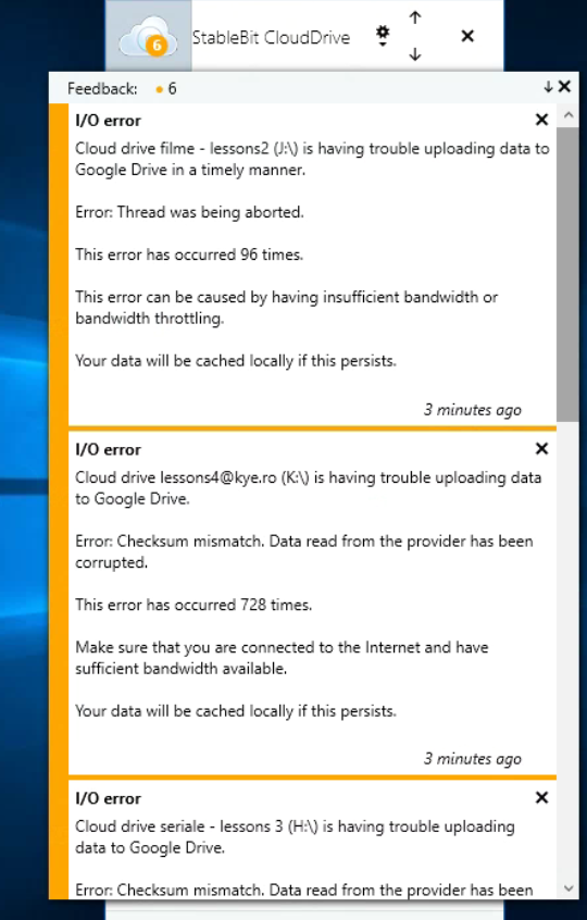

Hi. I have 3 different Gsuite accounts with unlimited space. I try to use the space for my Plex colletion ( i use plex for my family collection of movies and photos mainly , not the conema movie collection).
So i have 3 virtual stablebit drives on 3 accounts . Averything is encrypted.
After a few days, all 3 accounts don`t accept stablebit connections, i get errors. If i shutdown stablebit cloud drive for 48 hours or so, everything is back to normal for 2-3 days...
What am i doing wrong ? The uploaded data is not too much ( 2-3 gigs/day , rarely more than 10 )  . For me it`s some kind of API ban from gdrive....
Laso, i have scanner disabled in plex .
Here are the errors
2:20:42.5: Warning: 0 : [IoManager:58] Error performing read-modify-write I/O operation on provider. Retrying. Checksum mismatch. Data read from the provider has been corrupted.
2:20:42.5: Warning: 0 : [IoManager:129] Error performing read-modify-write I/O operation on provider. Retrying. Checksum mismatch. Data read from the provider has been corrupted.
2:20:42.5: Warning: 0 : [ChecksumBlocksChunkIoImplementation:59] Expected checksum mismatch for chunk 137, ChunkOffset=0x00C00300, ExpectedChecksum=0x87e9be2e581ad821, ComputedChecksum=0x41aff241ae641c63.
2:20:42.7: Warning: 0 : [IoManager:83] Error performing read-modify-write I/O operation on provider. Retrying. Checksum mismatch. Data read from the provider has been corrupted.
2:20:43.2: Warning: 0 : [ReadModifyWritePartialChunkRecoveryImplementation:59] Error reading chunk 137 for write (Offset=0x0000000000000000, Length=20971520). Retrying with duplicate chunk 439804651247 (DuplicatePart=2).
Attached data
New Text Document (2).txt
Link to comment
Share on other sites
It probably would have been better to submit a new thread for this question, as it only tangentially relates to the topic of the thread, and the Plex information in this particular thread is a bit outdated. So for anyone stumbling on this thread for up-to-date Plex information, you'll likely want to continue your search.
Now, that being said, the errors that you're seeing are data integrity check errors. CloudDrive is telling you that the data that it's getting from Google does not match the data that it expected to receive. So that leaves us with three possibilities: 1. CloudDrive has a bug and is, for some reason, expecting the wrong data; 2. Google is returning the wrong data when CloudDrive requests it; or, 3. That the data on Google's services is genuinely corrupt. My intuition says that 2 is the most likely--both because a bug like that should be more widely reported, and because genuine data corruption shouldn't resolve itself once in awhile--but determining which of them is actually the problem will require that you submit a ticket to the official support channel at https://stablebit.com/Contact so that they can troubleshoot with you.
Those are not, notably, API ban errors. And CloudDrive is effectively immune from the API bans that tools like rClone get simply by virtue of its method of operation anyway. So whatever is going on here is likely unrelated to the use of the API, unless Google has changed something without warning (again).
