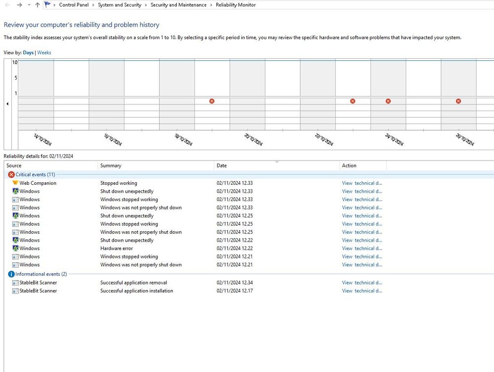

Came back to this thread 4 years later to share my experience,
Scanner is still causing BSOD.
My clients complain slow copying from my server.
HDD sentinel reports 2 drives with relocated event
But i only had 1 spare drive so i'd thought i'd use scanner to find out which one is worse.
But when scanner starts scanning, BSOD kicks in,
2 BSOD later, thankfully the OS still survives somehow.
I uninstalled scanner right away.
My server's been running for 2-3 years without BSOD so it's definitely has  something to do with scanner
