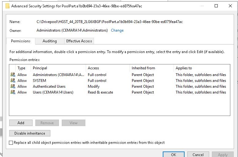

Whew, i don't know which one actually fixed it, but it suddenly showed up on my pool! I did everything above until the poolpart.guid cannot be renamed, so i tried putting the drive offline and online DP said one of the disk is missing, thats when i noticed it's back on the pool. Many thanks Shane saved me from massive headache of copying 20tb files! I almost reinstalled DP as well, i was too focused on finding the missing drive on the non-pooled Iist I didn't notice it's back on the pool -

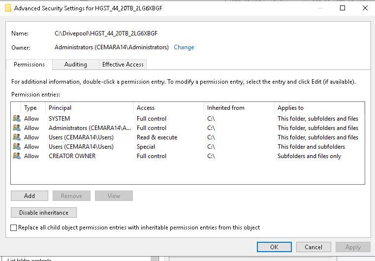

Hi, i woke up this morning after 1 drive removal to found out that other drive is missing from DP. but upon checking further, windows still detects the drive and the poolpart is still there I've tried rebooting and swapping the drive slot in the jbod but it remains the same. Checked the permissions and all are good, So I haven't done the troubleshooting in second step. Any other thoughts? One more thing, i was going to add another different drive but i'm hesitated because of this error, is it safe to do so under this error?
