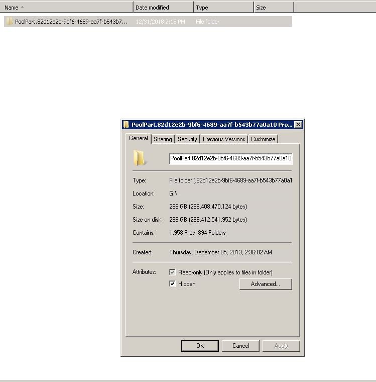

Here are the details of the problem:  DrivePool shows that one of the drives in my pool -- the G drive -- has over 2TB of "other" data on it.  (I have attached an image of the Drive Pool info.)  When I go to File Explorer and look at "My Computer," it does indeed suggest that there is well over 2TB of data on the drive.  (Image attached.)  But when I look at the drive in File Explorer, it confirms that the only thing on the drive is the pool part, and when I click on the properties of the pool part folder (image attached), it shows only 266GB in the pool part, which is roughly what DrivePool shows as the duplicated and unduplicated data on the drive.  There's nothing else on the drive.

Umfriend, I have tweaked my settings to show them, but I can't access them.  However, when I revealed the system folders, the drive shows a folder called found.000 that contains 2.15 TB.  Wow, that seems large.  I've looked over the contents, and it seems like duplicates of various other files I have.  I assume there was a problem.  So, two questions:

found.000 is where chkdisk throws "lost" files it finds on scan. For whatever reason the allocation table lost track of those files.I've never seen such a large number of them, but that's not to say it's not possible.
Review the folder delete whatever you don't need, move everything else to a Recovered folder within your pool and forget about it. If it happens again, then get worried.

Correct, this folder is created by CHKDSK when it finds files that it isn't sure of their actual location (eg, if the index got corrupted).
So you'd need to open this folder, and move the contents of this folder back into the pool.
