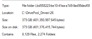

From what I can tell on this drive, is it appears to have the proper amount duplicated. But it has 388 GB of OTHER. So that is where the oddness comes into play.
Below are some screenshots of what I am seeing in case that helps.
