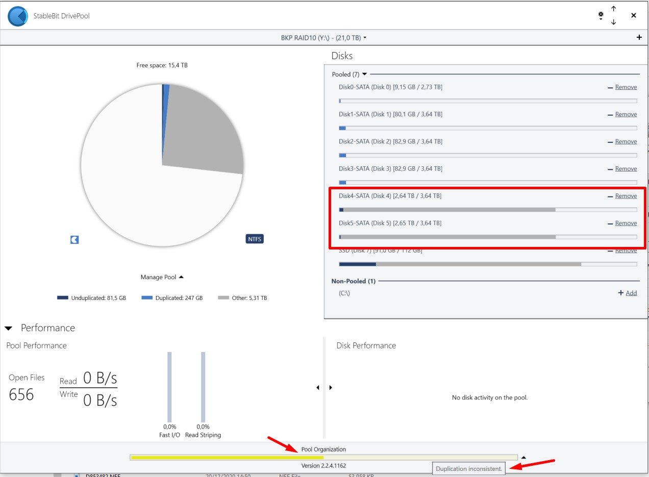

So, I've finally installed my DrivePool, copied everything to it, deleted my RAID10 and added all the drives to my pool. After that, I set a folder to be duplicated 3x. It started re-balancing and duplicating my files, but now, DP is stopped (nothing is happening) and it shows on the  Duplication Organization bar (which is yellow with the progress bar in the middle) the message Duplication Inconsistence. I've tried to re-balance and re-check duplication, but still nothing.
As a reminder, my scenario was:
I had a RAID10 with 4 discs and 5.6TB of data. I installed two new 4TB drives to my system and created a pool with them, so I had 7.5TB of free spaces. I then copied all my RAID10 files to my pool, without duplicating because I wasn't going to have enough space. After copying all the files and balancing was over, I deleted my RAID10, added all four drives to my pool and set a folder to be duplicated. It started duplicating and re-balacing, but it seems it didn't finish. I've attached a printscreen of my DP.

I'm suspecting a NTFS permissions issue, but (if you haven't already done so) could you test the following first?
* Manage Pool -> Re-measure...
* Cog icon -> Troubleshooting -> Recheck duplication...

The new screenshot looks much healthier!
If DrivePool is performing a duplication pass you will get a progress indicator (the Pool Organization bar will turn yellow and animated, and "Pool Organization" will instead say "Duplicating... (nn.n%)" where nn.n is the percentage so far.
If it is unable to complete duplication, the bar will be fixed at halfway and remain yellow, with a warning. Otherwise if it is successful it will return to the normal full green bar.
