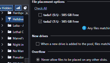

  • On the same pool, I set a File Placement rule to balance all the HD2 files onto one drive in the pool - as Shane suggested. Forced re-balance. Assigned a drive letter to both drives and verified that all files were indeed on one drive and that none were on the other. Verified game files' integrity. With or without read-striping enabled, it was still glitchy.

To show that I indeed had File Placement rules properly selected, in the one related attempt, here's a cropped screenshot of that menu:
