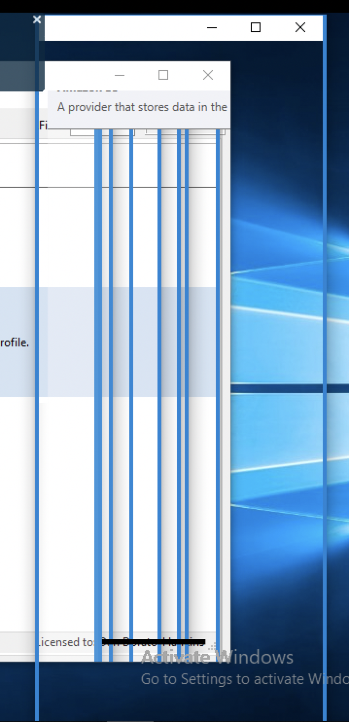

Dan Posted November 19, 2018 Posted November 19, 2018 When doing an RDP or other remote session into a headless workstation the CloudDrive UI never renders right. The second a monitor or NULL HDMI adaptor is connected (firing up the GPU) the UI renders fine. Is this a known issue? Quote
0 srcrist Posted November 21, 2018 Posted November 21, 2018 I use mine on a headless OVH server. I don't have this issue. Might it be a video driver problem? Have you tried a 3rd party RDP client? You can also just skip that process entirely and open the ports required for remote access within CloudDrive and run the UI locally. That might be an option for you. See :https://stablebit.com/Support/CloudDrive/Manual?Section=Remote Control Quote
0 Christopher (Drashna) Posted November 21, 2018 Posted November 21, 2018 Make sure that you're on the latest version. There was a known issue with RDP, but should be fixed. Quote
