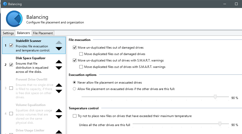

JscoLP Posted April 1, 2018 Posted April 1, 2018 I can't get my pool to balance with a simple strategy: Scanner has priority to control damaged drives Disk Space Equalizer is based on percent used Would like a simple balance where all drives are filled as best as possible to the same percent, but I can't force a balance or anything? Quote

0 Christopher (Drashna) Posted May 1, 2018 Posted May 1, 2018 Try resetting all the settings: http://wiki.covecube.com/StableBit_DrivePool_Q2299585B Then in the main balancing settings, set the ratio to 100% and disable the "or this amount" (paraphrased) option. http://stablebit.com/Support/DrivePool/2.X/Manual?Section=Balancing Settings#When is Balancing Necessary? Then disable ALL of the other balances (including StableBit Scanner), and see if that works. If not, and your on the 920 build, then .... Quote
0 JscoLP Posted May 2, 2018 Author Posted May 2, 2018 Yep that did it, on build 920 and reset all settings then set balancing as you said. Overnight it reached about 99% balanced (not exactly perfect) but close enough! Thank you!! Jaga 1 Quote
