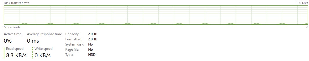

Also to add to this I have disabled my network adapter and completely stopped the search service, so I see no open file handles what so ever on the drivepool drive, yet I still get this 5s access light going off and can hear the head move
Just so I know Im not going crazy taskmgr does show the periodic activity, the one shown below is the drivepool 'drive' which I think is just a 2TB sized placeholder, if I go under the individual USB disks that have no drive letter that are in the pool I also see the same accesses at the same time. So it's like the entire pool is being pinged every 5s

I brought it up via support and they gave me some options so for future reference
1) Run chkdsk on each volume
2) Disable bitlocker detection (https://wiki.covecube.com/StableBit_DrivePool_2.x_Advanced_Settings)
3) SMART queries via scanner, so enable smart throttling
In my instance I had already done chkdsk on all of my volumes. So I moved on to #2, when I checked the settings.json it was actually just full of nul's, so first I stopped pool, deleted the file, restarted pool to let it generate a valid one, then I disabled the bitlocker detection. For me one of those 2 things, either having an invalid settings.json or disabling the bitlocker detection, appears to have fixed it for me
