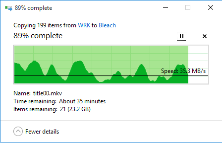

The graph below was taken during the process of copying ~199 files in multiple directories of various sizes (15K - 780 GiB) for a total of ~225 GiB.
Fig 1: Copy To Storage Spaces 2012-R2 mirrored pool
What isn't apparent from the graph above are the *numerous* stalls where the transfer rate would dwindle down to 0 for 2-5 seconds at a time. The peaks are ~50 MB/s. Took *forever* to copy that batch over.

What a huge difference in performance!  I didn't believe it the first time.  So, of course, I repeated it, with the same results.
Has anyone else noticed this enormous performance delta between Storage Spaces and DrivePool?
I think the problem is with the writes to the mirrored storage pool, I had no problems with stalls or inconsistent transfer rates when reading large batches of files from the pool managed by Storage Spaces. The write performance is utterly horrid and unacceptable!
