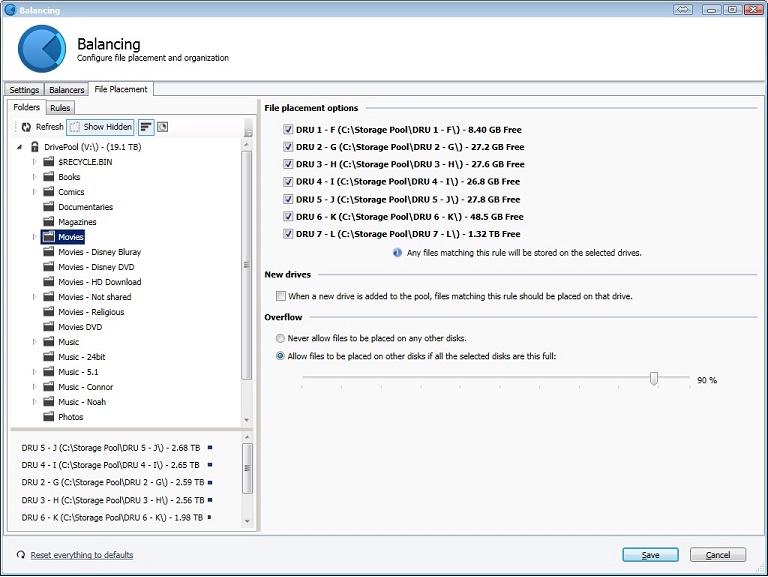

And as for the files being placed on teh wrong disk, did you have a file placement rule limiting the placement of the file?
If you did, then the settings on the "General" balancing tab will control how this is handled.

By default, this plug-in will override any folder based or pattern based file placement rules. In order for folder based
or pattern based rules to take priority over this plug-in you can change the balancing settings on the "Settings" tab
as follows:
  • UNCHECK "File placement rules respect real-time file placement limits set by the balancing plug-ins."
  • CHECK "Balancing plug-ins respect file placement rules."
  • UNCHECK "Unless the drive is being emptied."
Make sure that you set this, if you're using both the Ordered File Placement balancer and file placement rules.
Otherwise, ... well, you may notice issues. Which may be the case here. And sorry for not picking up on that earlier, as well.
Just tried all of what you posted, checked all settings again. All balancers except OFP remain disabled and I don't have any file placement rules.
Initially, I saw the same behavior. OFP was still trying to place a 16GB test file on my F drive which is already close to my 99% full rule at 28.5GB free. My K drive has 48.xGB free so, it should be the one getting the 16GB test file.....
I reset the OFP balancer settings and started over, settings same as before. Now, no matter what, ALL files (even a 1.6GB file) are going to L drive which has the largest amount of free space (around 50% free) despite the OFP balancer being active.

Ha! Thanks was having a problem with using snapraid and the ordered file placement plugin respecting file placement rules solved it in a jiffy thanks. Trying snapraid because my limited server filling up with dup files. I have yet to try a restore with snapraid still trying to get things in order and this really helps out. I also haven't overfilled a drive yet to reproduce habe's question I'm sure it won't be long before that happens. I can set the limiter down to see if I can reproduce the problem here if you all would like me to try. I will be doing a snapraid sync soon so let me know.
