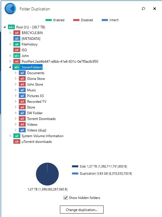

  10. Update: Not quite back to normal yet. After allowing duplication and balance to sort sort out, I realized that there was still to much space being taken considering I had added a 12TB drive. Then I noticed that only when I accessed the pool folder there was a separate pool listed as PoolPart.2_XX as seen below. Final point is that the main pool has lots of empty sub folders (lost movies) and that most exist in PoolPart.2 Most of the "lost files" can be accessed there. Should I just copy the duplicate files into to the main pool to recover them and then delete PoolPart.2 to recover space. Thanks
  11. Go into manage pool and selection change duplication. Should show 3 now and type in 2.
