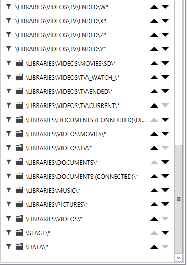

  17. Re-ordering rules still doesn't seem to work for me. I can drag and drop and sort them exactly how I want, but when I hit save and re-open the rules list they have completely reverted. I reset all settings, de-activated my license, uninstalled, rebooted, deleted C:\ProgramData\StableBit DrivePool, reinstalled, reactivated, and set back up my rules. Same behavior. Not sure what's going on?

  22. I just updated to build 510. The order of the rules now looks to be a pretty random jumble and when I manually position them the order reverts to the jumble after I hit save and re-open the list of placement rules. Any ideas?
