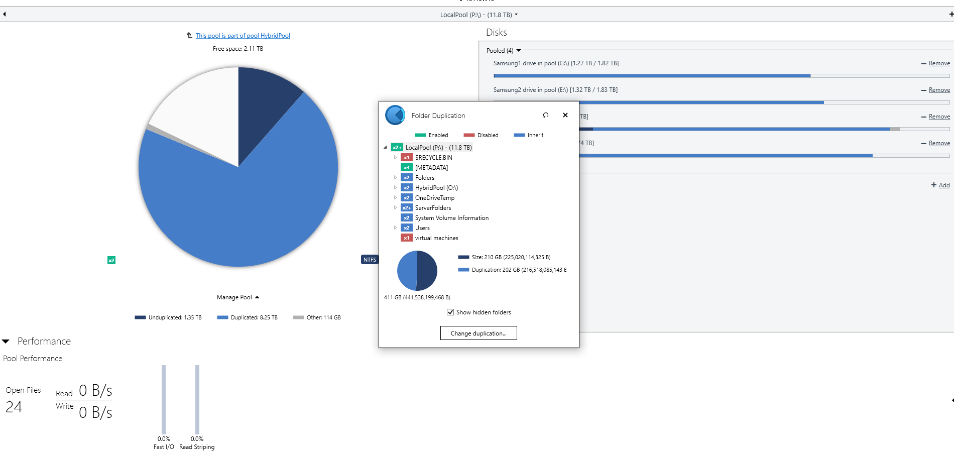

  24. Well I gave this a go and hit a brick wall as the parent pool, containing my local and cloud pools, do not 'see' the folders/files in the local pool. Specifically I following the walk through examples mentioned here: https://blog.covecube.com/2017/09/stablebit-drivepool-2-2-0-847-beta/ When I try do folder duplication (or the relevant balancing) all I get are the hidden folders and not any of the folders within my LocalPool. This is contrary to what I expected in the walk through examples mentioned in the above link. Here is what I'm getting: This is what my LocalPool looks like. (NB, the sizes mentioned are incorrect, DP was still counting when I grabbed the screenshot). Clearly I have done something wrong but for the life of me don't see what. Any ideas please? cheers Edward
