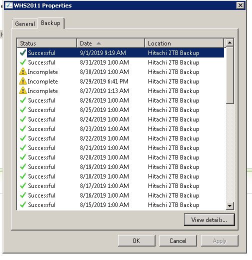

I had a failing drive. System backup only did a partial backup.
I replaced the drive, let DP do its work, then found a lot of missing files.  I assume they were on the failed drive.  When I try to do a restore files from the external drive, I can only access ones the were created after the new drive was installed.  All previous backups listed are grayed out and not accessible for retrieval.  I think the data is still on the external system backup drive but I don't know how to retrieve it.  Any suggestions?  Thank you.

I fear though that your backups are lost. You have two 2TB HDDs that you backup (I think) to a 2TB HDD. Server Backup does try to retain backups but once the backup HDD becomes full, it will wipe and do a new fresh full backup. As you have added a new HDD and that HDD will have had data on it, chances are that the BUP HDD got full and wiped.
This is speculation on my part.
What you could try to do is to locate the large .vhd files on the BUP HDD and have explorer show the "Date created". My guess is that it will show August 31st, around 1 AM...

Thank you.  The oldest date for a .vhd file is 9/1/19.
 I think you are right about over writing.  When I installed the new drive I failed to uncheck the box to back up "Videos" (689 GB).  I normally don't do a server back up for videos so that is what took up so much space.  I still hope there is some way to recover my lost data.  Thanks for your help.  If you have any other suggestions please pass along.

That is Date modified. You can add a column for date created and that is what I am looking for. Date modified will always be the last date you ran a backup and that is fine.
TBH, I don't think there is a way to recover.
