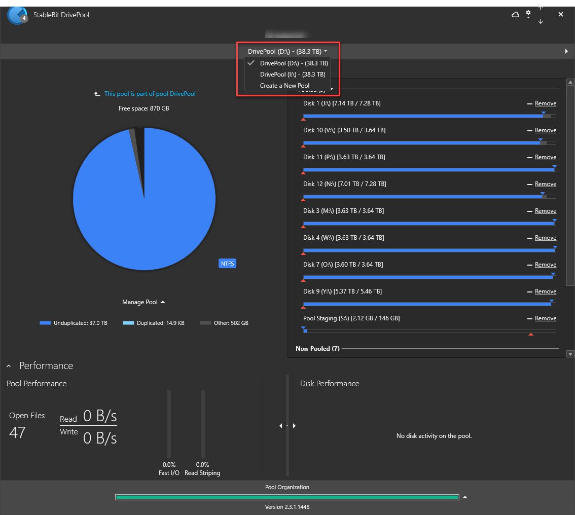

Attached pic shows what I'm talking about. Usually the Pooled view shows a list of all ~10 disks which make up the pool. Same goes for 2nd screenshot.

I kind of found the issue. I noticed that "I:\" was selected as the pool when the pool is "D:\". Clicking it I was able to select D:\ from the dropdown and everything displayed normally. Not sure why "I:\" is an option, but it is - even after a restart. Odd. I isn't mapped to any partition currently and believe it was the next available drive letter prior to drive swap.

Below you can see that Disk Management lists two pools even though I only have one. I am about to perform a clean OS reinstall and am waiting to see if there's action I should take first to address this issue(?) before proceeding. Thanks!
