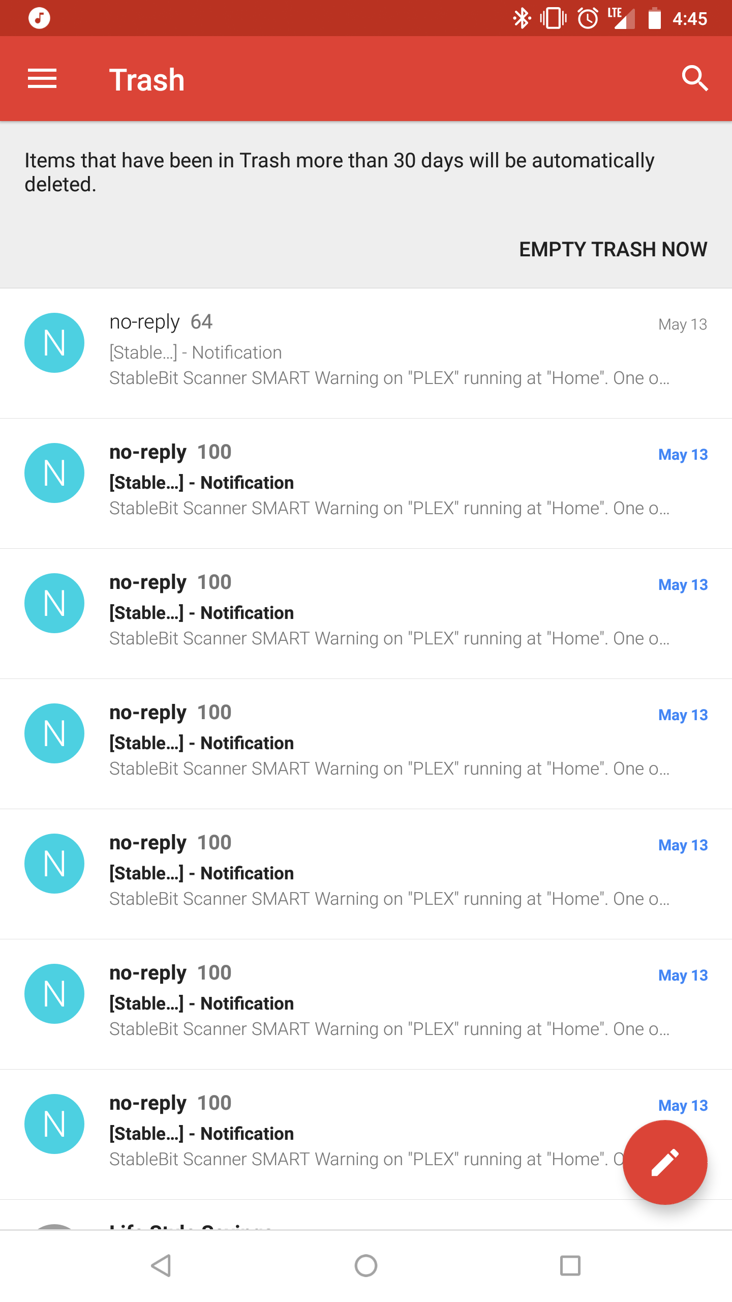

Here is a photo of my trash from my email lol also was getting texts like crazy too! Now if I was to enable folder duplicate would I be able to just reformat the drive without losing data.

Scanner told me i have a 1 bad sector count. Any way for the software to repair it? Also i am using 2.5.2.3178 and the Notifications enable i keep getting text and emails none stop till i ignored the alert. I love getting the alerts but maybe adding a setting to only send a few instead of ALL the time or maybe set it by hours or days...
