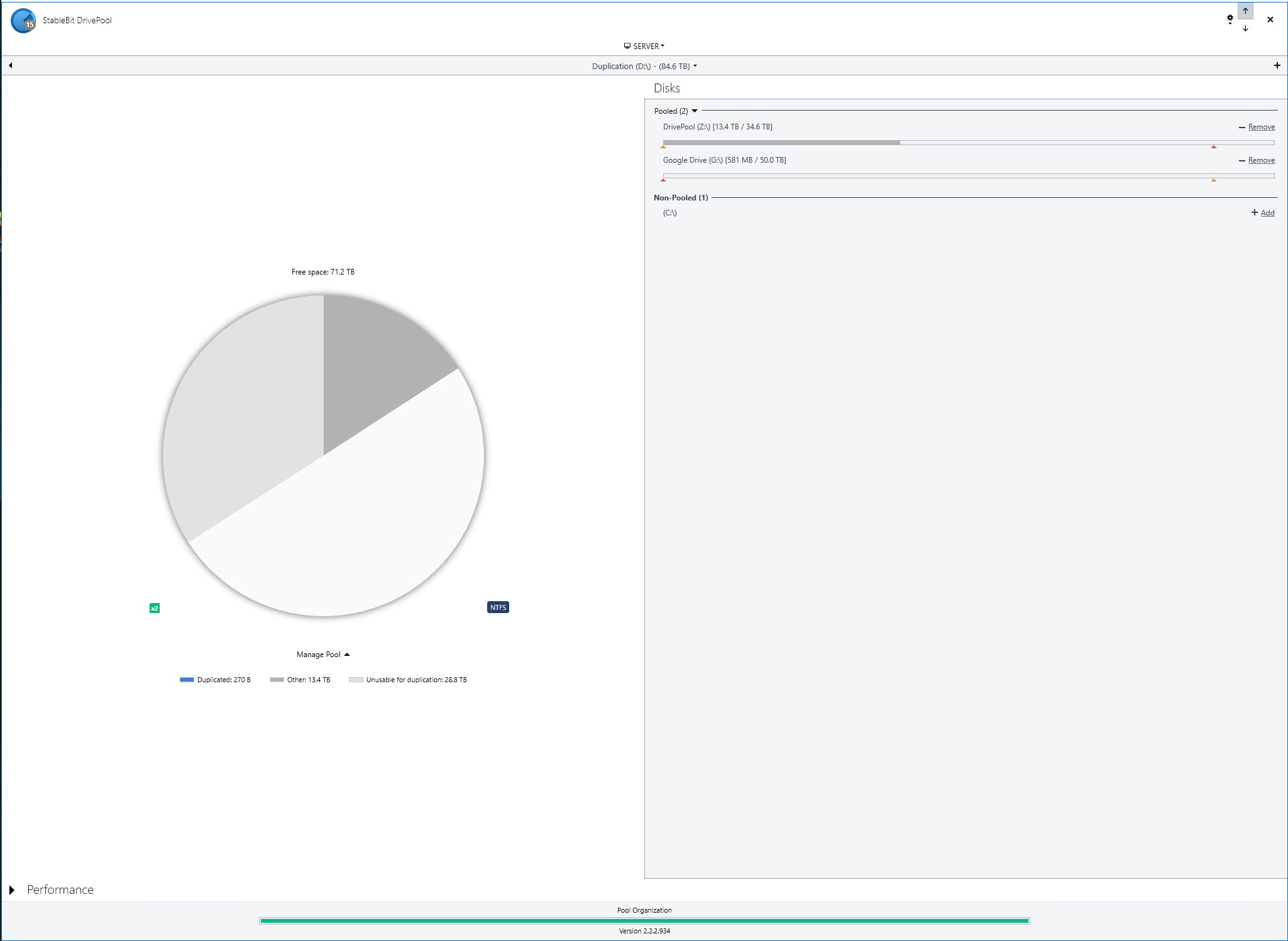

OK. Just so I understand this correctly. I will end up with 3 pools? 1) Z:\DrivePool (Current - All local disks) 2) D:\Google Drive (New - Cloud Drive) 3) E:\Combined (Newer - Includes DrivePool and Google Drive)
Ok, when I click create pool, this is what I see. How do i remove the drives from my current pool without losing data?
