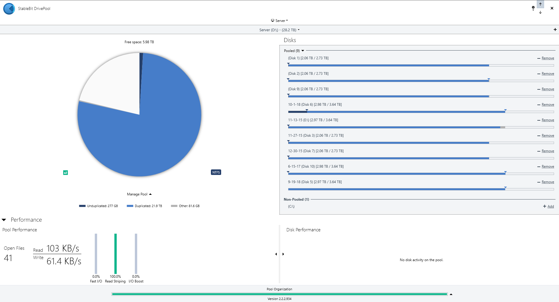

Thanks again Umfriend. I'm running a duplication consistency scan via the command line exe you referred me to. I will report back after that is done. Just some additional info: the "unduplicated" files seem to be growing. They are up to 277 GB now (see attached picture). I'm really perplexed as to what is going on here.
Well my main ssd drive that hosts all the system files isn't part of my pool. These "new" unduplicated files just showed up on my new drive only. Would there be additional hidden system files within the pool? Is there a way to see what files are in the "unduplicated" portion?
