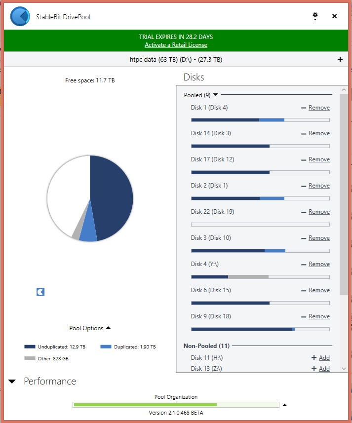

As the screen captures show, I am using the latest beta, have 9 pooled drives, and one of my drives (an empty 3 TB) will not take any files at all despite balancing options set to equalize. I've left it this way for two days, with balancing options set to immediate and three reboots in between. Any help would be appreciated.

Just loaded the latest x64 beta (468) and the problem above is fixed (I have 9 drives in the pool and 9 are listed) To date: pleased with your product and it's brother Scanner. Of the 20 disks in my previous Drivebender pool, I had 7 damaged disks and no way to know this unless I accessed the data. Not sure where to post this either - but I'm finding that Drivebender's way of duplication (via hidden folder with folder.duplicate.something) makes the file name often way too long to copy over. Win8.1 throws fits at a number of my nested folders deep inside these duplicates forcing me to go all the way down, find the file, and then manually copy it over. Not sure how you guys do your duplication...just throwing that out there. -

I've attached a screenshot. I have 8 drives in the pool, but the pool is only reporting 5. Am I doing something wrong or is this a bug?
