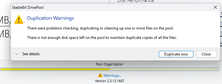

I can nearly post the same screen shots from 6 year ago (as above) Duplicate file taking up far more space then they should

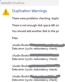

below warning is showing files have been deleted from the pool and the recycling bin  ?
But the pool will NOT reorganize because its hitting an error with file not in the pool ?
something need a major refresh how do i do it ?

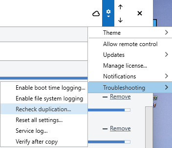

OK Found this  the warning it not popping up .. thinking this may be a over night Recheck Duplication ?
You've got at least two problems, but the big one is the "Data error (cyclic redundancy check)" warning - that means that DrivePool couldn't read some files on one or more of your disks because the data was corrupted. This could be a sign of a failing disk, faulty controller or bad RAM. I'd recommend a RAM test first, and if that passes then I'd check the affected files to find out which disk(s) is problematic. Since you have duplication enabled you can (hopefully) compare the copies to find out which ones are still readable.
The "Data error (cyclic redundancy check)" on those files is due to me deleting them from the pool afew days ago
so a file deleted 3+ day ago is creating a error that is stopping the remeasure operation.
how to FORCE a remeasure or a recheck of what really need to be duplicated
That's weird, DrivePool's directory structure is collaged in RAM from the disks in the pool, it's not permanently stored separately. Try restarting the computer?
To force a remeasure from the GUI you can click Manage Pool then click Re-measure...
