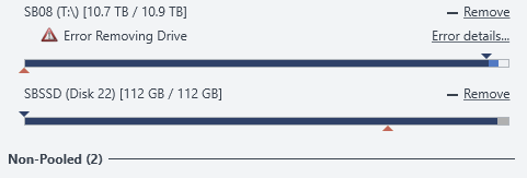

I am trying to remove a drive that won't remove, which Stablebit Scanner is telling me has no problems. After almost 5 days, I just want to remove it and I will manually move the files over to the pool but DrivePool will not let the drive go!
Starting at the top:
1) Tried to remove the drive traditional method and got Error "The directory name is invalid".

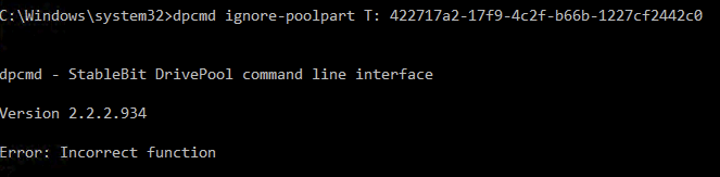

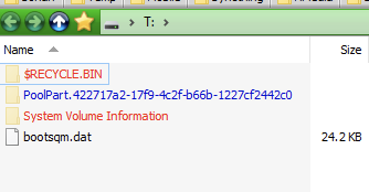

Ok this didn't work. Let me add more info here.
This is the drive I am trying to remove. Just to make sure I got the poolpart info correct.
Ran the command in command prompt.
Ran it in an admin elevated command prompt.
I did it in powershell as well and got the same results, including the same error in elevated shell.
Drivepool will not let the drive go.
What can I do now?
2 hours ago, Shane said:
As per above "T" has to be the pool's drive letter, not the poolpart disk's drive letter.
So if your pool drive letter was instead "P" then you would use:
dpcmd ignore-poolpart P: 422717a2-17f9-4c2f-b66b-1227cf2442c0
Duh, that was it, thank you!
