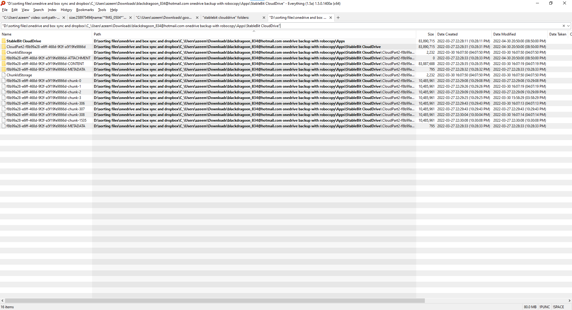

anmac1789 Posted October 25, 2025 Posted October 25, 2025 Hello, I have the following files from previous installation of cloud drive. What can I do with this ? can I restore this data ? Quote
0 Shane Posted October 26, 2025 Posted October 26, 2025 Assuming it's a complete download of a clouddrive folder from OneDrive, either you could upload a copy of the folder back to a OneDrive account and reconnect to it there or you could convert it (but make a backup first just in case) to a LocalDisk format using the CloudDrive.Convert.exe tool that comes with CloudDrive and reconnect to it locally. If it's only a partial download I don't know how well either would work (might depend on how much is intact); if the data is critical I'd suggest opening a support ticket with StableBit via the contact form for technical support. Note that if encryption was enabled for the clouddrive then you would also need to have the phrase or key that was chosen for that clouddrive (if the option to automatically unlock the drive on boot was used, this may still be recorded in the computer originally used to access the clouddrive). Quote
