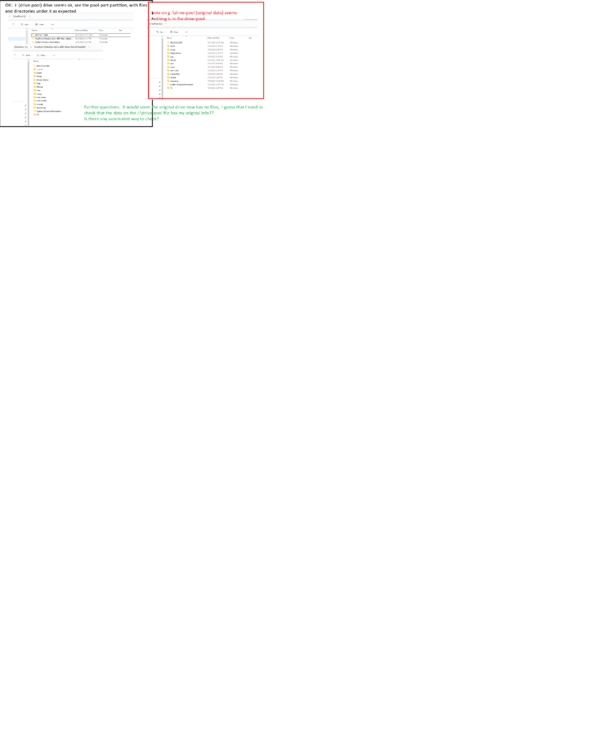

OK:  SO my robocopy file program has completed.
I think I need some help, as I should have done the stuff in your previous suggestion .
my drivepool (J:) now shows most of my files
(and here is the J: drive)
J:\>dir *. /b
all-watched
batch
bkups
books
cheryl-shows
fm-mitch-lap-2-bkups-etc
logs
Movies
new
robocopy
streaming
tmp
tmp2
TV
video-pgms
SO  that looks good, so far

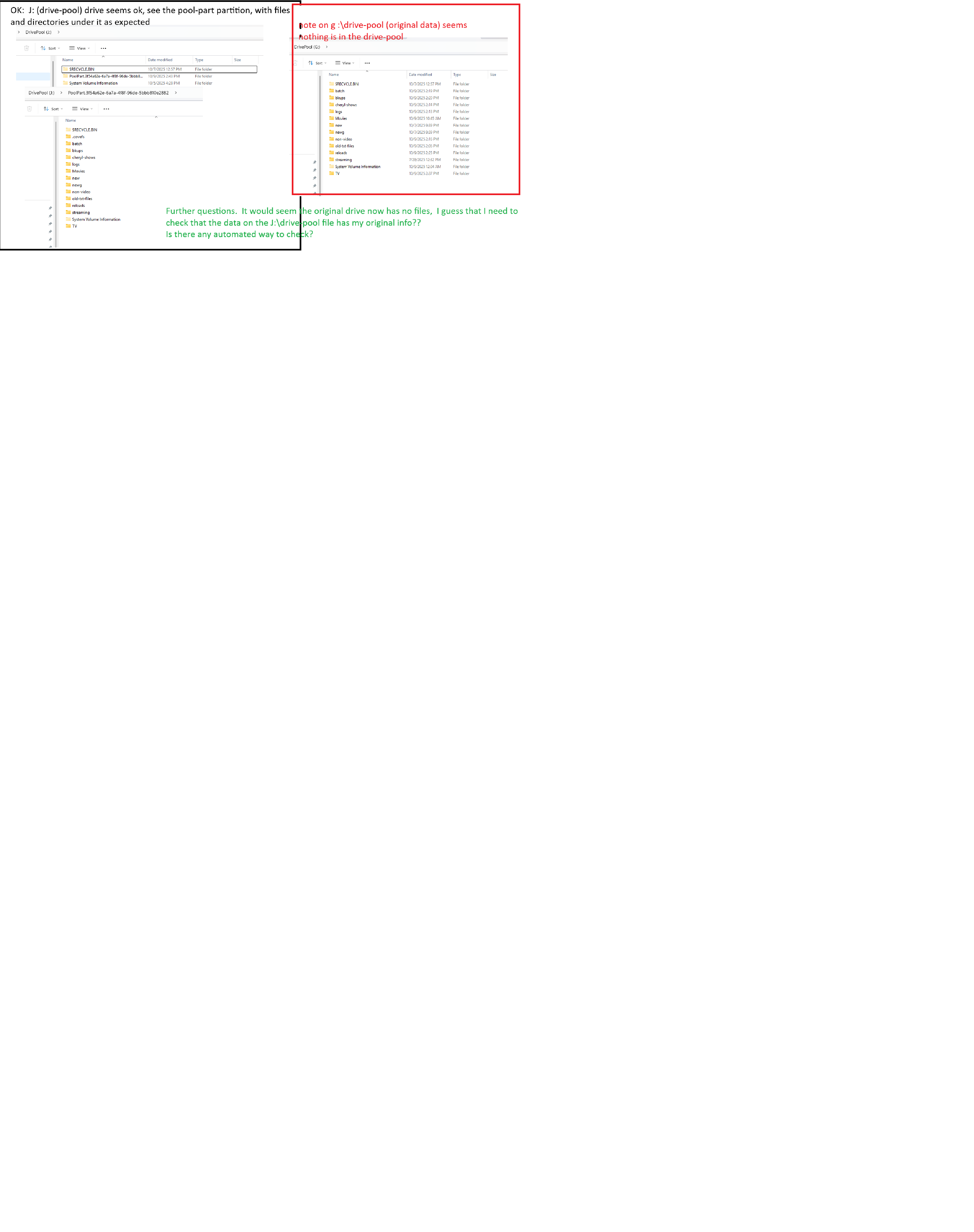

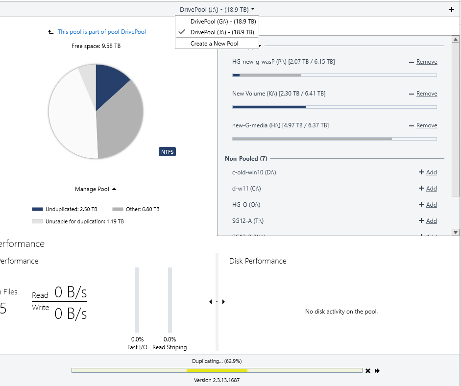

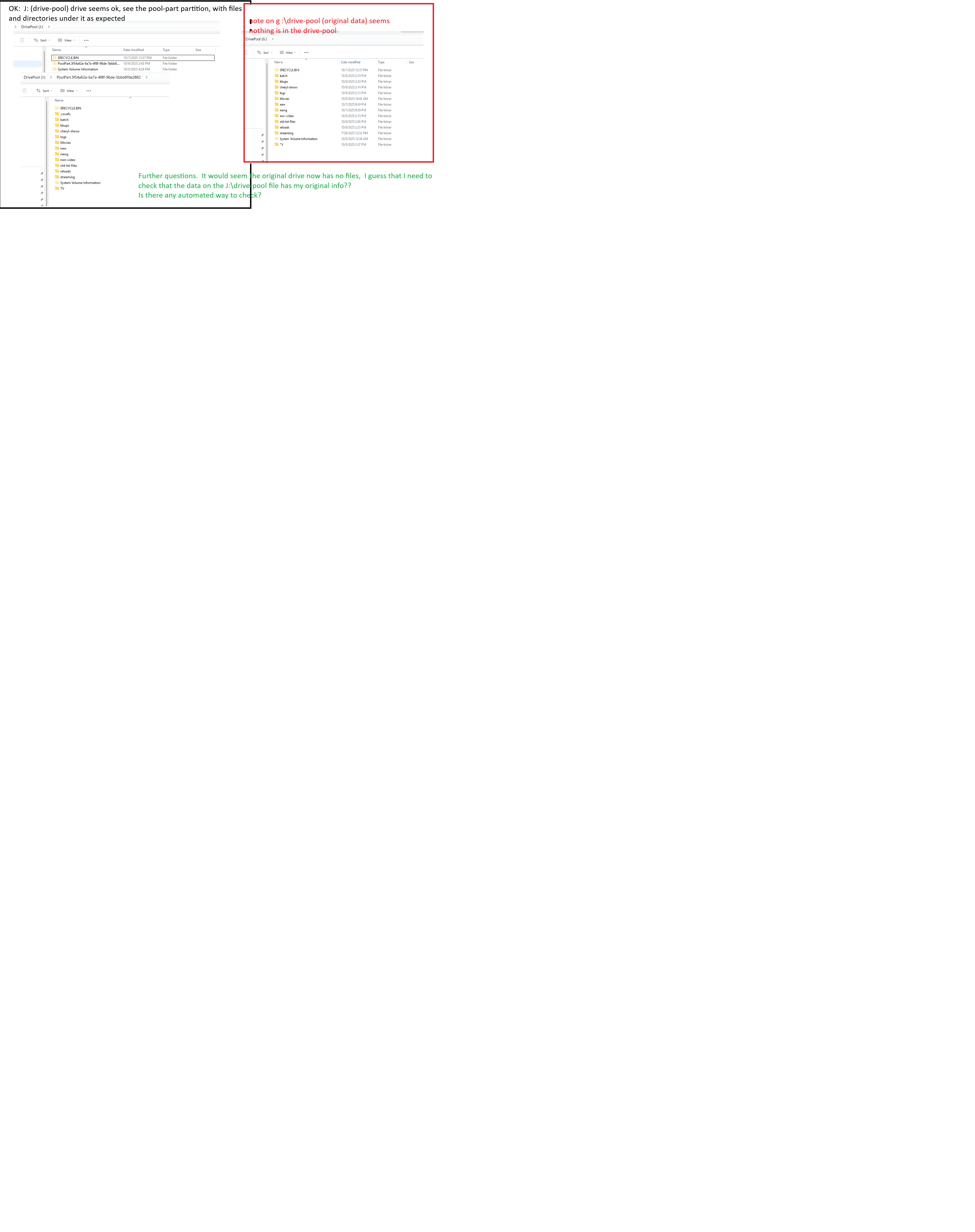

Now, I essentially did that, and now (see photo) shows I have a G and a J drive pool (I think)
using the g drive, and the j: drive,  I did this, and am unsure what the 2  drive-pools mean (1 drive pool, or 2??
thanks again for your assistance!
Sorry, I didn't see a way of editing my previous question.
I included an additional screen shot, showing the J: drive pool, (which does have the poolpart.x directorties with everything in it)
(so that is obviously ok)
as well as the G:drive pool which only shows the original files. with no pool-part directory.
(which means it's not really part of the drive-pool info...
Further steps?

From the screenshots it looks like you've created two pools, but with the second pool using the first pool as one of its disks (i.e. you've added the first pool as a "disk" to the second pool). This is called nested or hierarchical pooling:
  • J is your first pool; its disks consist of physical disks P, K and H.
  • G is your second pool; its disks consist of pool J and any other disks that you added to it (not visible in the screenshots).
The poolpart.* folders are where a pool's content is stored on each of the disks that form the pool (normally these folders are not visible to the user because they have the Hidden attribute).
  • J's poolpart folders should be on P, K and H. So where you see X:\PoolPart.exampleJ (where X is P, K and/or H, and exampleJ is the unique identifier string that DrivePool uses to identify that pool on that disk) that is the folder where the content of pool J is stored on P, K and H. If you manually inserted a file or folder into the root of one of those poolpart folders, it would show up in the root of J and so on.
  • G's poolpart folders should be on J and any other disks that you added to it. So where you see J:\PoolPart.exampleG that is where G is stored on J. If you manually inserted a file or folder into the root of one of those poolpart folders, it would show up in the root of G and so on.
  • Since one of G's poolpart folders is on J, that poolpart folder will also be a subfolder on P, K and/or H. So you should see a X:\PoolPart.exampleJ\PoolPart.exampleG that is that folder where it actually physically resides in the physical disks P, K and/or H. If you manually inserted a file or folder into one of those poolpartexampleJ.\poolpart.exampleG folders, it would show up in G.
Does that help make sense of your layout?
So basically if in pool J you had a file "J:\mypicture.gif" and you moved it to "J:\PoolPart.exampleG\mypicture.gif" it would show up in pool G as "G:\mypicture.gif". Note that manually moving content into a poolpart folder risks confusing DrivePool, because you're skipping DrivePool's safety checks such as "is there already content by that name in the same place on one of the other poolparts that form that pool" and "does this have the correct duplication level assigned to it". So be careful if you do this.
P.S. Manually moving a poolpart folder itself (rather than just moving content into or out of it) will definitely confuse DrivePool. Do not do that.
