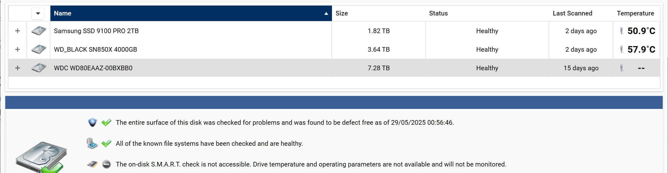

There is no SMART information in Scanner, and the temperature isn't shown, while my NVMe drives show up fine.
The message shown is:
Quote
The on-disk S.M.A.R.T. check is not accessible. Drive temperature and operating parameters are not available and will not be monitored.

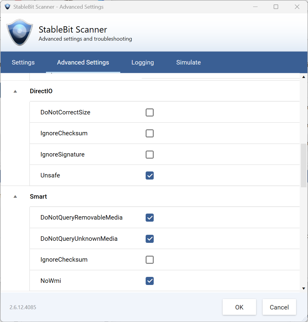

I have tried toggling the Advanced "Unsafe" Direct IO and the "NoWmi" options, but neither have made a difference (I restarted the service in-between changing the settings, and have rebooted a few times since as well).

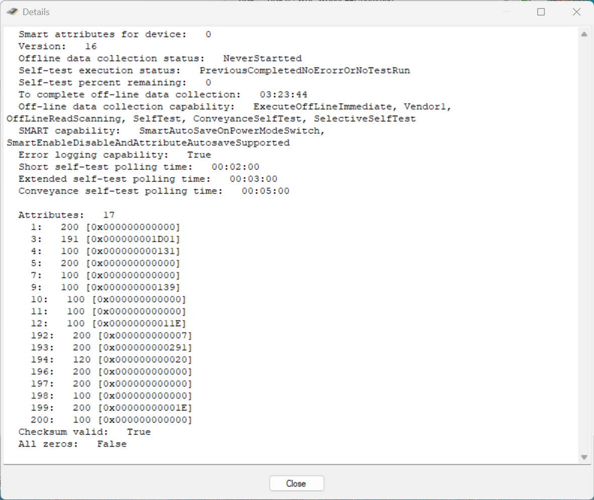

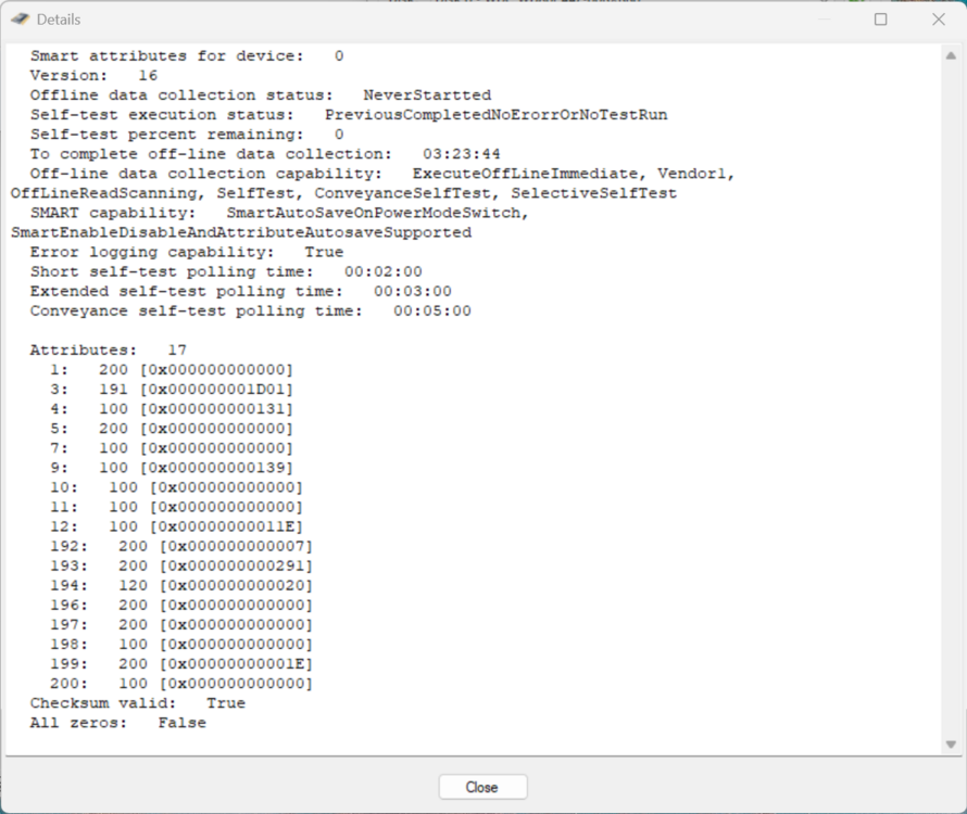

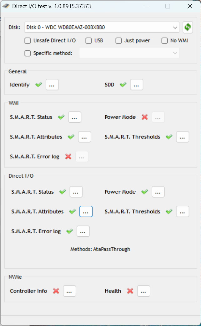

I have tried the Direct IO Test program DirectIoTest-1_0_8915_37373.exe, and this appears to work fine, and I can see SMART attributes including Attribute 194 showing 0x20 (32C).
What else can I try to get Scanner to read the SMART attributes of my drive?
