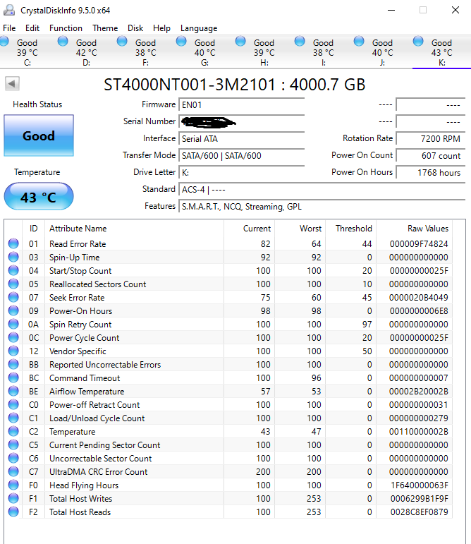

The problem I posted in Feb 2025 has returned (see above) but not the same HDD. The HDD in question is a Seagate IronWolf Pro 4TB manufactured in Sept 2024. I ran chkdsk; no problems reported.  I ran Seagate seatools short & long generic tests, both tests passed. I've attached a cystaldisk image; no problems indicated even after repeated refreshes (F6). I changed the HDD data cable & SATA port; no difference.

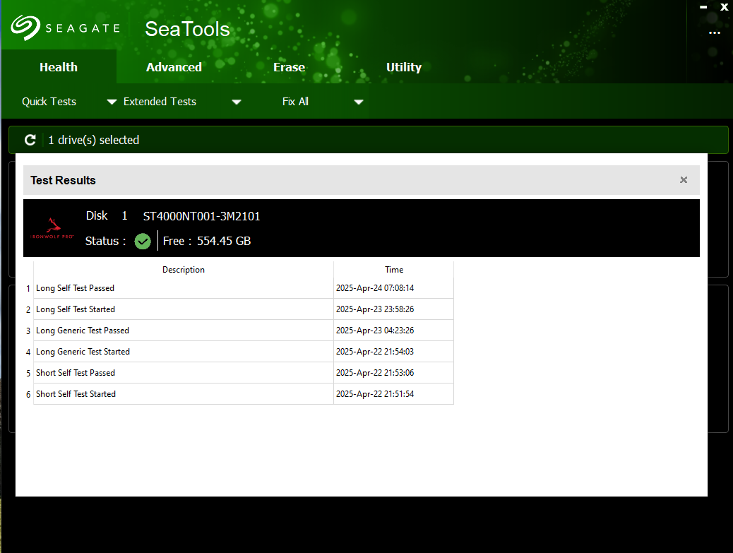

I've added the Seagate Seetools test results below; as can be seen, all tests passed but SB scanner flagged bad sectors as soon as I re-connected the HDD. HDD regenerator reported issues with 7 sectors & recommended backing up the HDD.
Would Seagate reject a warranty claim based on their test results?
