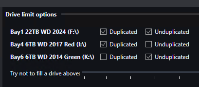

#4
I am confused with the "Duplicated" and "Unduplicated" meaning.
For me till now there was the "Original" file and the "Copy" of the original file, thats what I am used to from DriveBender.
But it looks like for DrivePool, there is no Original and Copy of it. All are handled as originals.
But to make sure I get it right:
Duplicated = All Files that have 2 or more Copies (Files marked to have duplication)
Unduplicated = File that have only one entity on one drive. (Files set to not have duplications)
So about how the options are set here means:
On Bay1 there can be Files that have only one entity and also files that have many copies.
Bay4 only accepts files that are set to have copies. (in this case the file would be saved in Bay1 and Bay4 but not allowed in Bay6)
And Bay6 accepts only the files that will not have any duplications.
Did I understand that correct?
If yes, that would mean I block any file that is set to have at least one duplication, to be saved on the drive in Bay6 accordig to my understanding.
What would happen if there is a larg folder (2TB) on Bay6 that had no duplication till now and I now change it to have a duplication.
Will DrivePool remove that folder from Bay6 and save 2TB on Bay1 and 2TB on Bay4? Or will it stay on Bay6 and make the copy on Bay1 or Bay4?
  • Correct, and while I'm not sure whether it would "duplicate first and move second" or "move first and duplicate second" (I'd guess the former) the end result would be the duplicated files being on both Bay1 and Bay4 and no longer on Bay6.
