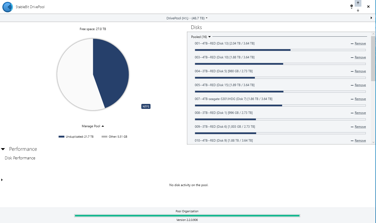

Drashna,
I know this is an old thread but ..... would cluster size have anything to do with "unusable for duplication 637GB"?
I pulled a 4TB WD RED from an existing NTFS pool on my win10pro workstation, formatted it ReFS (I can't remember what the cluster setting was, 64K or 4096 bytes) and started a new pool with it. I disabled duplication on both pools. Then I started moving files over to new ReFS pool. This created enough space to remove a 2TB drive from old pool. I formatted that drive ReFS and set cluster to 64K.
Then I removed my 2 SSDs from old pool, formatted them to ReFS (64k) and added to new pool.
I am now sitting at 637GB of unusable space for duplication. I haven't even turned duplication on yet as I have another 24 TB to move to new pool!
I installed drivepool version 2.2.0.906 when I first saw this problem and both pools are on the same system. I have included captures of old and new pool.
PS. Love Drivepool, can't wait for you guys to fully support ReFS!!

I was wondering about the free space on the new pool.  Since my original question, I formatted all the drives on the new ReFS pool with a cluster size of 4096 and with a 2nd 4TB drive added all my "problems" went away. I was getting worried for a bit there but thanks for the comment "But if you're not using duplication, you can ignore it, as it won't affect your free space. " I feel a bit better, I will re-enable duplication once I am sure I have enough disks to support my new pool.
Wow, it takes a while to move 24TB of data!!
Thanks again everyone!
Yeah, it's mostly letting you know there is an issue.  The Duplication Space Optimizer balancer actually will actively move data around to eliminate the "Unusable for Duplication" space.  So over time, you'd see this drop down (hopefully)
As for moving the data .... 4 hours per TB, roughly. Longer if the pool is doing it and being used....  So that's 2-3 days .....
